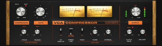

Voltage-Controlled Amplifier (VCA) Compressors​
The most widely prevalent type-the VCA compressor, named as such because the output level is controlled via a voltage-controlled amplifier. Compressors of this type generally provide the most detailed and precise control over the entire dynamic processing workflow, offering the user direct access to most or all of the aforementioned parameters, and for this reason are considered the most flexible and versatile. VCA compressors are characterized by high responsiveness, making them an ideal choice for working with sounds containing numerous pronounced transients: for example, snare drum, clean electric guitar, acoustic guitar, and similar instruments. They also deliver excellent results when tightening and stabilizing bass guitar and kick drum.

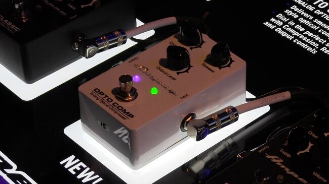

Optical Compressors (Opto)​
At the constructive core of an optical compressor lies an optocoupler-essentially a combination of a light-emitting diode and a light-dependent resistor housed within a single compact enclosure. The amplitude of the input audio signal controls the LED's brightness intensity, which in turn causes a change in the electrical resistance of the photoresistor. This variable resistance is then used to smoothly regulate the compressor's output signal level.
Optical compressors are capable of delivering exceptionally natural, musical, and smooth compression even under heavy processing demands, making them particularly sought-after for processing finished mixes and mastering tasks. They are also excellently suited for preliminary input signal processing when recording vocals and acoustic instruments.

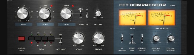

Field-Effect Transistor (FET) Compressors​
FET compressors utilize a field-effect transistor as the key element of their dynamic control circuitry, endowing them with exceptional responsiveness to aggressive and fast transients characteristic of drum kits, overdriven electric guitars, and various percussion instruments. They also excel at smoothing the dynamics of sources possessing a wide dynamic range, such as vocal performances (both singing and spoken word), piano, synthesizers, and other expressive instruments.

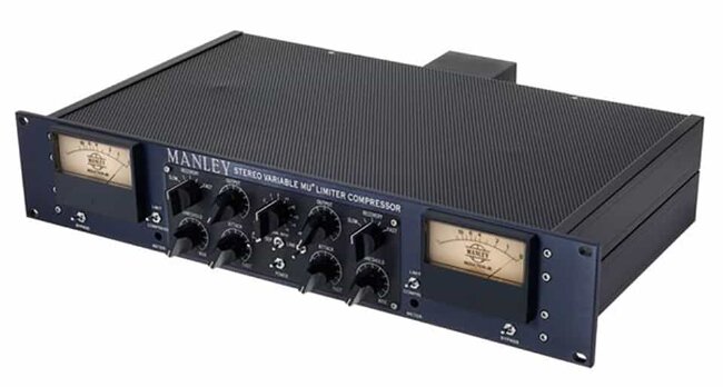

Variable Mu Compressors​
Exotically named and relatively uncommon in mainstream practice, the Variable Mu compressor employs a vacuum tube as the controlling element for regulating the output signal, imparting characteristic tube warmth, harmonic richness, and unique coloration to the processed sound. Compressors of this type typically offer a degree of user control comparable to VCA compressors, while simultaneously possessing a significantly smoother, more transparent, and musical sonic character. This makes them an ideal choice for final processing of completed mixes and professional mastering.
